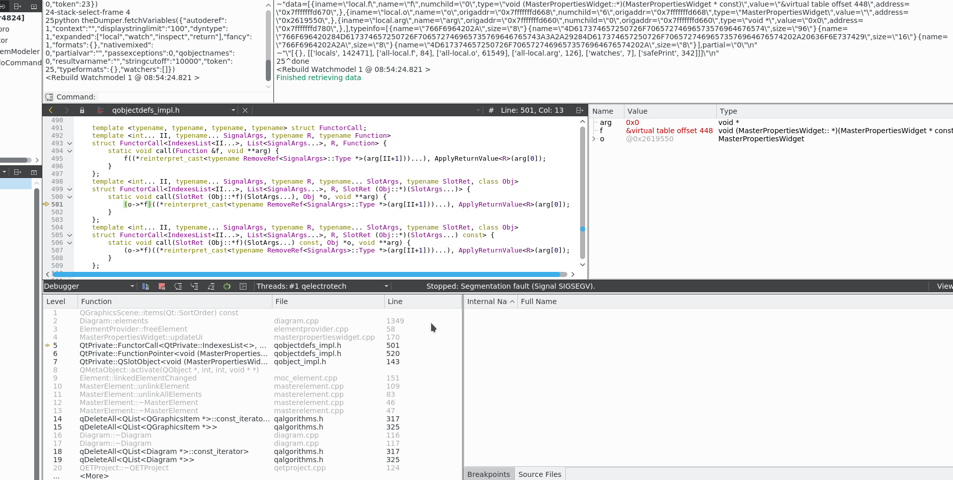

| Summary | 0000128: Crash when quitting r4823 | ||||
| Description | When i closed the QET window by the [x] window frame button, i got this crash caught by running it in debug from qtcreator. Screenshot attached. I believe - but am not 100% sure - i did not edit anything before last save. I believe it is r4823 as svn up did not download anything, but said anyway it is r4824 as it report latest version in another branch https://qelectrotech.org/forum/viewtopic.php?pid=6053#p6053 | ||||
| Attached Files | |||||

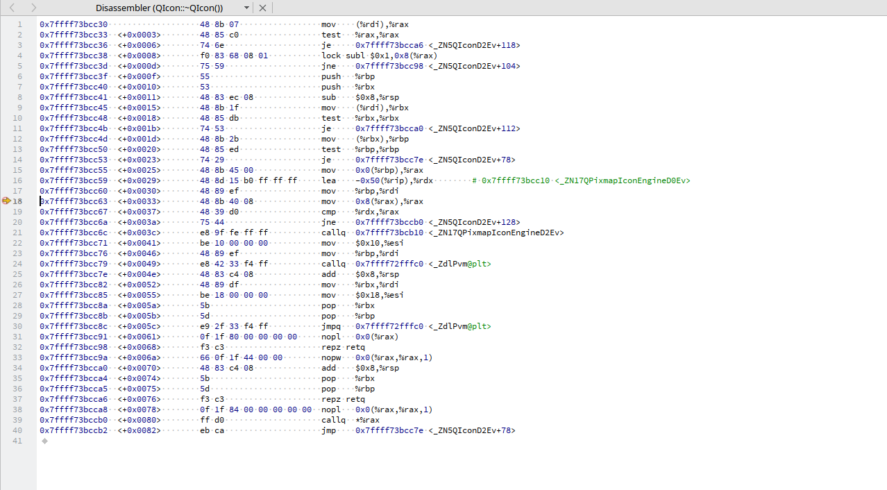

Launch QET, new project, close :
screen Backport upstream change to fix crashes on exit in some applications
Qt 5.7.1+dfsg-3 Dmitry Shachnev (8): Start a new changelog entry. Backport upstream change to fix accessibility-related crashes. Backport upstream fix to make QGtk3Dialog not crash on Wayland. Backport upstream change to fix crashes on exit in some applications. Close bug #850746 in the changelog. Revert "Backport upstream change to fix crashes on exit in some applications." Backport change to stop unloading plugins in QPluginLoader and QFactoryLoader. Release to unstable. |
