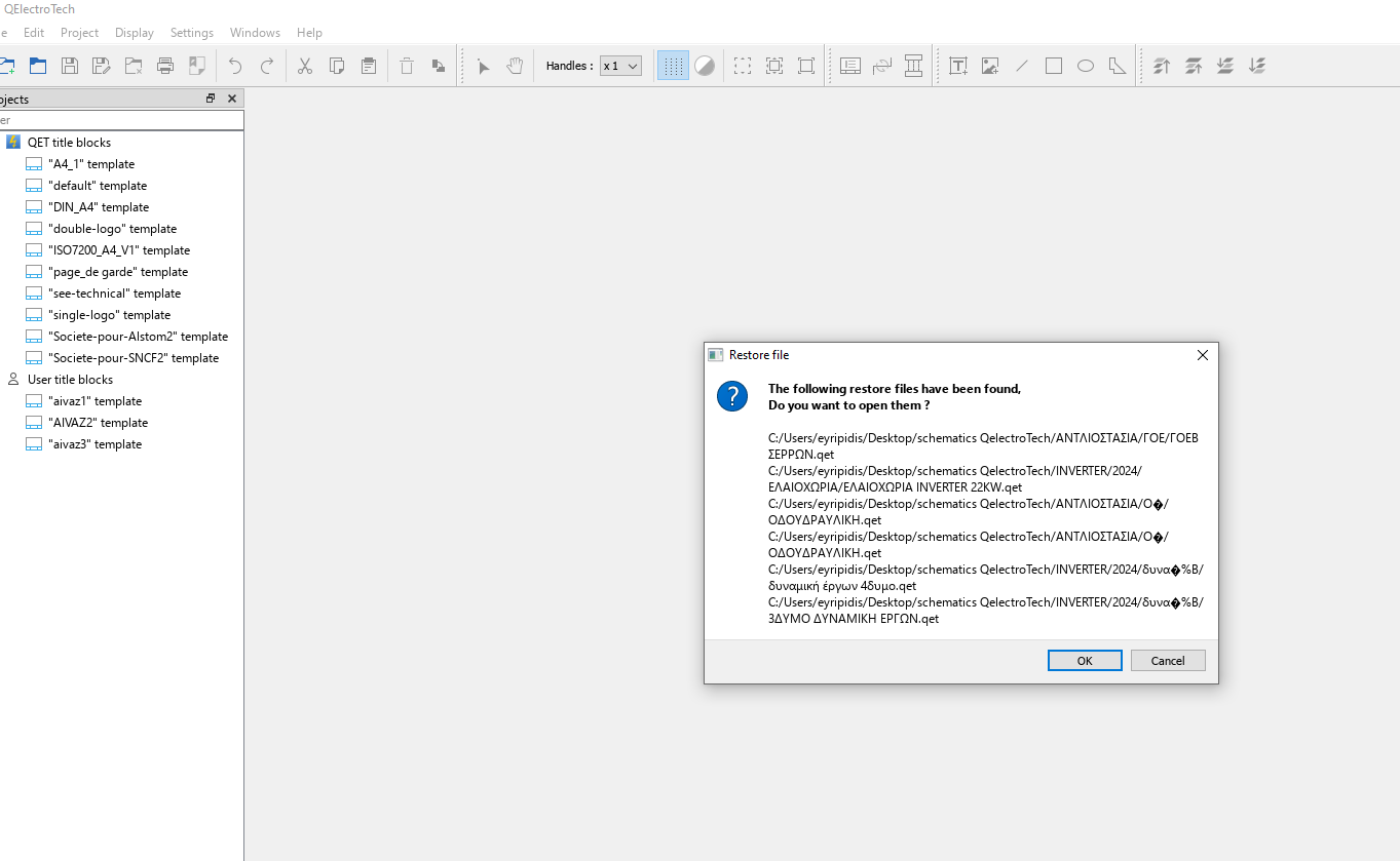

DescriptionEvery time I open the program I see a pop up saying "the following restore files have been found. Do you want to open them?" and then a list of files below. When I press cancel I can enter the program just fine. When I press ok to open them, program crashes. I can open these files just fine from within the program or from their respective folders. I would like to get rid of the restore screen if possible? It just keeps adding more files to restore in the list.

administrator   ~0000715
https://qelectrotech.org/bugtracker/view.php?id=209
jojo
2024-06-04 09:00
reporter   ~0000720
Thank you scorpio810, solved.
